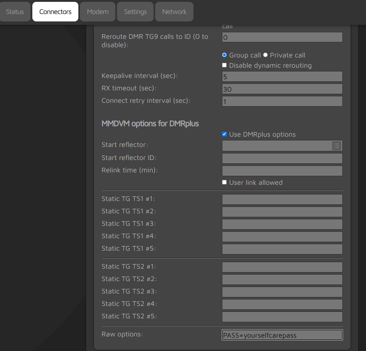

OpenSPOT 4
Connectors → DMR → Raw options:
PASS=yourpassword

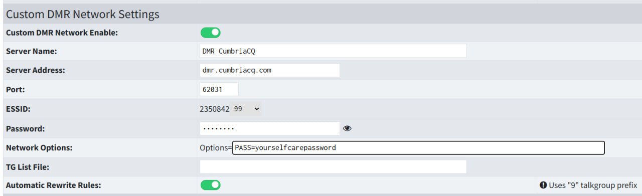

WPSD / Pi-Star
Custom DMR Network → Network Options. WPSD shows Options= already — add only:
PASS=yourpassword
Server dmr.cumbriacq.com port 62031. The Password box is Homebrew, not Selfcare.
